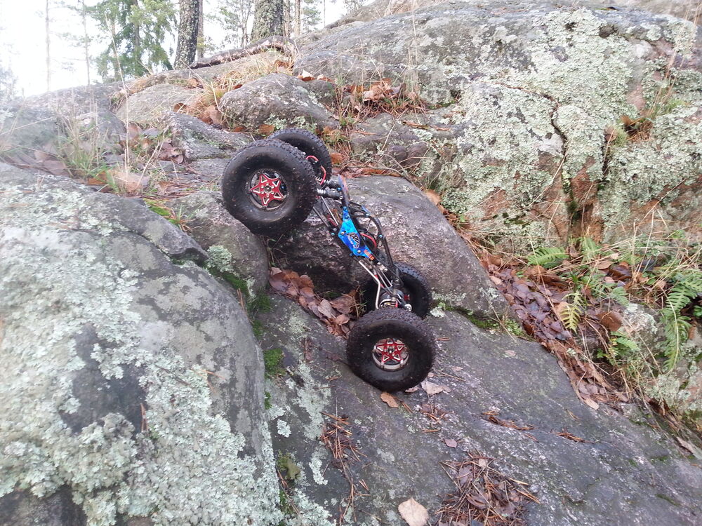

Laitetaas ihmeisilli ihmeteltäväksi ja mietittäväksi kuva autosta...
No ei laitetakkaan kun kuva häviää heti!
No kerrotaan pikkasen speksei.
Runkona Y-townin tekele
Aksulat XR10
Motteina Team broodin nexukset

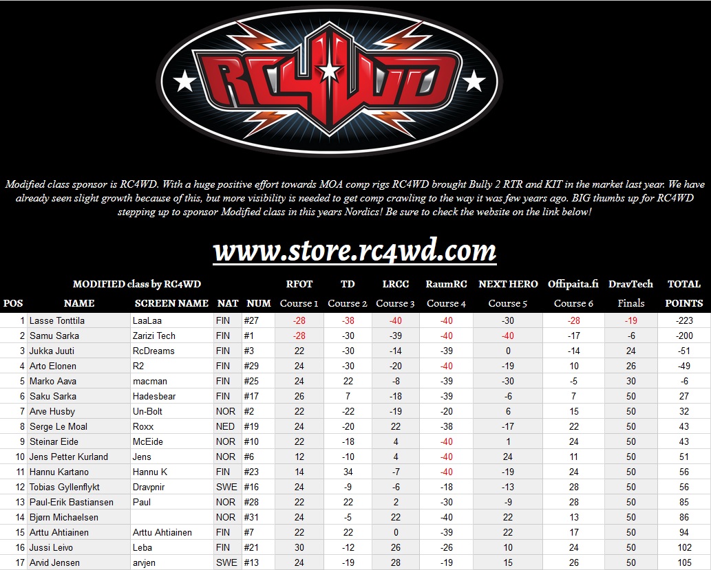

Let's start from Finnish Nationals series comp 5/5 Rauma
U can see that not so good day for me... I didn't have any confidence that day.
No pics from the comp.
It was really thight fight for the championship
Samu & Laalaa was equal points before last comp 8)
And the winner...
Congratulations to Samu for winning Finnish national champion ship!!
Becouse the last comp bad driving i felldown 1 spot. 5th place still

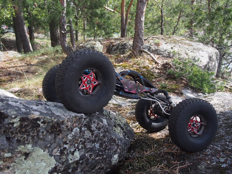

Old links work nicely. Here is couple pics.
The other upper link is little bit bend. It don't matter it works so no need for new one... Or do i?? Yes i need new uppers when i order the new rear axle from Y-town
Here is some measurement pics.
Full Droop
highest position.

I bought used Team Brood stubbies!
Not cheapest buy these things keep their price even used.
Brood Stubbies 30t with crazy addons.
Made motor covers from old vial pottle and painted them black.
These pictures are taken after the season -17 was over so not anymore so black
Gained few grams more weight from Nexus motors.
First pic is with Brood Nexus motors and no roof.
Second one is with Brood Stubbys and roof on.
If i remember correct the roof + zipties was 5grams.
So gained 33grams from the Stubbies and vial covers.
It don't matter. The extra torque and speed fix that weight gain.

3rd place and cool viking trophy to take home!!!
Nordics 2017 - Vantaa, Finland MODIFIED 1.jpg (296.17 KiB) Katsottu 5582 kertaa
Samu and Laalaa was their own class.
I need much more training and comps before i can start to comp with their level.
It was very close battle for the 3rd place. Arto was only 2 points away!
Luckly i won!
